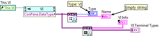

There is Invoke Node Set connector pane. It modifies control (VI ref type). The node works well for setting connector pane of existing VI to control; i.e. connector pane is read from VI (as Variant) and set to control.
Is there any way to assemble this Variant without involving any source VI?
May be there is a way for modifying this Variant?

Look at what data is contained in that variant wire as an example for what it is looking for.  Then use variant functions to build it.  It might be clusters, it might be variant attributes.  It could be anything.
(3,378 Views)
Yes, it could be anything. See:
The Variant type is VI. Get VI Information receives this Variant and returns all info about terminals.
I need something opposite; i.e. I need to "wrap" array of variants (VI Terminal Types) in Variant of VI type.

Your best option may be to flatten-to-string, identify and replace the VI terminal types, and unflatten.
(3,348 Views)
Accepted by topic author _Y_
The following VI allows you to construct a VI data type (i.e. a conpane data type):
LabVIEW 20xx\vi.lib\Utility\Data Type\Set VI Information.vi
Note that this VI is not officially supported by NI.
(3,340 Views)
Thank you Darren, it works well.
There are other problems with setting terminal pattern but I am not sure they are related to this VI. I shall ask more if not succeed on my own.
