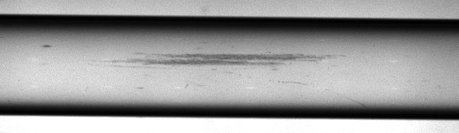

I would like to detect scratches in a surface.
The surface is like this:
And I would like to detect scratches like these:
Any ideas to detect this kind of scratches? I have tried with texture detection. Is it the better way?
Thanks a lot.

There are many images, some with scratches and others without them.
I want to identify the images that have the scratches and color them in the same image.
But yes, I want to show the scratch in the image that have an scratch (or scratches).

Then in that case ,you can try some image histogram based scratch detection technique which will identify higher frequencies for the scratch areas...

If you are lucky enough to have the Vision Development Module, 'IMAQ Find Edge.vi' can be configured to give you this pretty quickly:
For that, the green bounding box is hardcoded: I gave it pixel counts for left right top and bottom of the box, then told it to search top to bottom for one edge and bottom to top for another edge. You'd have to code it a bit more eloquently to detect scratches everywhere, and I don't really know how you'd go about coloring in the scratch as you want to do. But this is where I'd start. Hope this helped.

I have tried with texture defect detection and also have good results.

You could likely use binary thresholding and particle analysis to color and calculate information (position, area, perimeter, number of scratches, etc.) for the scratches.
Just search 'particle' in the NI Example Finder and look at the various particle detection example VIs.  Requires the NI Vision Development Module.
