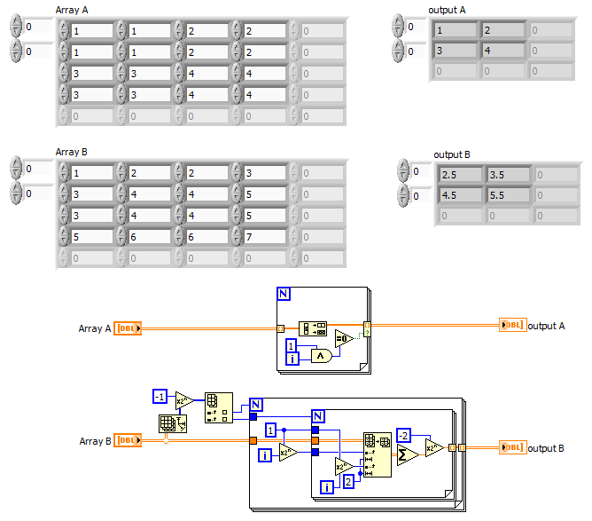

Scale/Bin a 2-D Array
Has anyone scaled or binned a 2-D array before?  If so, could you give some information on your method?
Example of problem:
                                    initial array                 scaled array (skipped every other)
scale array by 50%:    1   1   2   2                   1   2
                                    1   1   2   2                   3   4
                                    3   3   4   4
                                    3   3   4   4
                                    initial array                 binned array (averaged in quads)
bin by 2 array:             1   2   2   3                   2.5   3.5
                                    3   4   4   5                   4.5   5.5
                                    3   4   4   5
                                    5   6   6   7
Thanks!

(Wow, this was an very old thread (>>10 years!)  you revived here! :D)
Here's what I would probably do (but probably more scalable so a reduction factor is an input and sanity checks are performed if the input sizes are not correctly divisible).

I like your solution.  Should be faster.
