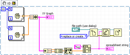

PRP,
Here is how you could save xy data to a text file.  There is no need to use the dynamic data type in this case.
Chris M
