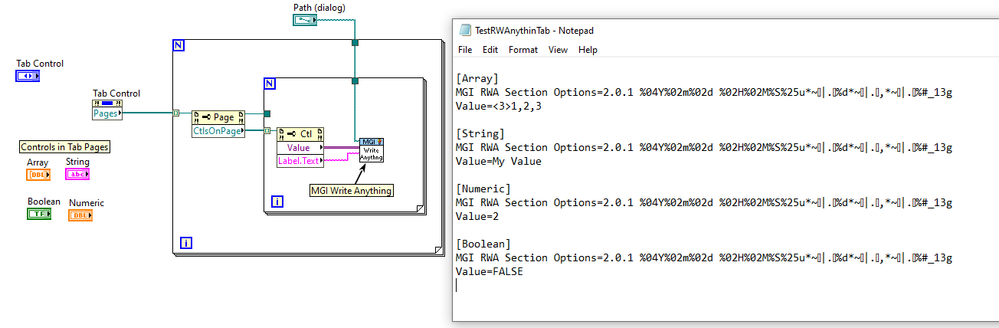

If you do NOT need to use an Excel sheet then the following may work for you with minimal coding:
  1. Use VIPM to install MGI Read/Write Anything
  2. Make sure all your controls have unique labels. Use captions if labels need to be identical.
  3. The following below will save text file of all of the controls and their values, excluding the tab values, but that can be added in. Also I assumed all the controls are in the tabs, once again modify to add other controls.
Message 7 of 9
(1,885 Views)
