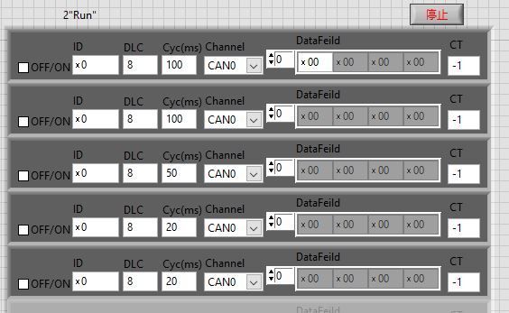

Same PC hardware ,same LabVIEW version and different Windows OS.
The original design aims to simulate CAN node to transmit CAN messages cyclically with different periods. Setting waiting-time equal to 1ms is used as time quantum.When the elapse time is integer times of period of certain message, the message needs to be transmit. The period ,purely up to the user's definition, is changeable.

Simple solution: Switch back to Win7 when it was working more stable for your requirement!
You cannot rely on OS timing for plain Windows in the millisecond range. Point. Even on Win7 you might get such problems like you face now…
Suggestions:
  • You might try the timed while loop, it might improve timing behaviour a little bit (but it still runs on your plain Win10 OS with its limitations).
  • You might try to split your different messages into some kind of actors, each one running on its own loop speed handling only one ArbID/message…
  • You might change to a realtime target, like a cRIO, when you need realtime behaviour.
  • You might employ hardware abilities. Your CAN device might be able to send CAN messages with afixed delay on its own…
