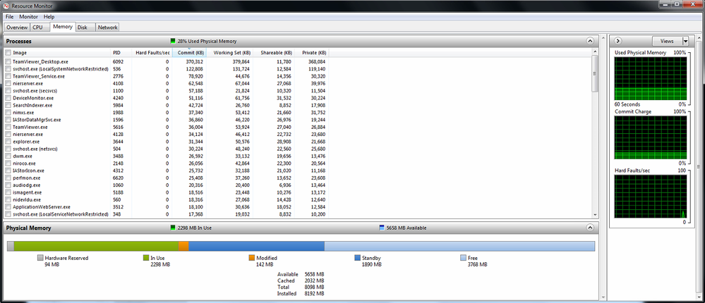

There are six testers that have been running the same LabVIEW application (Environmental TestVIEW.exe) for a while. So far three of them had the following memory problem. The OS is Windows 7.
One day I noticed the physical memory usage was 88% on one of the testers when I took a look at the Windows Task Manager.
I also opened the Resource Monitor. I noticed the orange part ('modified') of the physical memory bar is huge.
I closed the LabVIEW app. The RAM usage dropped from 88% to 83%.
I rebooted Windows and waited for some minutes. (I forgot to click 'Show processes from all users' on the Task Manager this time.)
How should I interpret this memory situation? What might be hogging the RAM so much? Could the LabVIEW app be the culprit?
This is a serious problem for reliable long-term tests. Any insight would be greatly appreciated.

TeamViewer seems to be eating up as much memory as your LabVIEW app.
How much RAM does your PC have?
Message 4 of 9
(4,113 Views)
8 GB. It's shown in the Resource Monitor screenshots.

My apologies!  Looking at your screenshots I read "TeamViewer" as "TestVIEW".  I didn't look close enough - just assumed it was an additional thread.  Looking more closely, I don't think your TestVIEW seems to be using up an unreasonable about of memory - depending on what you're doing with it.
It also looks like you have plenty of physical memory available, but have run out of commit charge.  Not that you couldn't do a search yourself... but 30 seconds of GoogleFu returned this.  Maybe it'll help.

I am noticing a lot of svchost threads running.  Are you doing a bunch of TCP communications or .NET or command line?  Can't think of what else I have seen that with.  But it typically comes from not properly closing out resources.

Some terms the Task Manager uses seems to be misleading. My focus should've been high commit charge. Thank you for pointing in the right direction!

The LabVIEW program is based on the Actor Framework and extensively uses NI TestStand API to run SEQ files where UI messages are constantly sent. It controls NI 9477 & 9422 modules and XNET devices for CAN communication.
