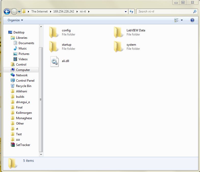

I have tried the first solution, first I copied the DLL to the c:\ni-rt\ali.dll
then I adressed the DLL on Call Library Function Node as:
But I got the following error:
I also tried the second solution, I adress the DLL as "ali.dll" . The following picture shows that the build process do not let to select any file (also DLL) as Always included.
What should I do?
Message 10 of 59
