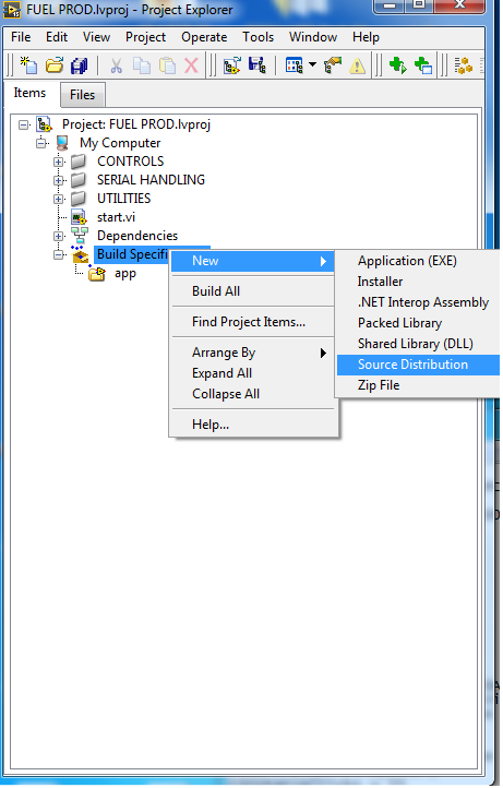

Once you create this DLL add it to the list of StartupDLLs in your ni-rt.ini file under the [LVRT] key.
Then create a new Labview project and create a DLL of it (like in this example http://ftp.ni.com/pub/devzone/tut/calllvbuiltdllfromcpp.zip) make sure this contains a function called Startup.vi and that the Labview generated dll is named 2ndStageLoader.dll (dont mind DLLPrintf, it's a debug helper I made)
Startup.vi diagram is like follows
now close the Labview DLL project and create a standalone VI called starter.vi (discard the PRINT E vi, just my debug)
Now you are ready to run your project.
Create a new project and add a source distribution, make sure the source distribution name is app and that the LLB name is going to be app.llb
start.vi is the starting point of you application
In the source distribution properties make sure that under "Source Files" the start.vi is always included
The Destination Directory under Destination is set as LLB
And additional exclusion must look like this
Now using any FTP client, just drop the ni-rt.ini in you LVRT pc root folder, then add the
2ndStageLoader.dll, starter.vi and app.llb into you real-time PC ni-rt\startup folder and just reboot after reeboting the Injector will load the 2nd Stage Loader and wait 15 seconds (to allow the RT to finish loading) then it will call it's Startup function, which in turn will call the starter.vi which will then start your app by calling start.vi
