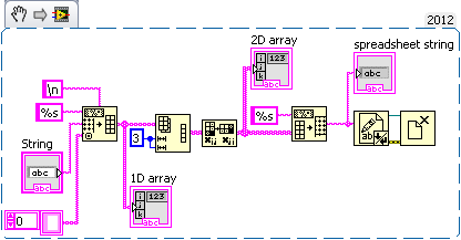

Message 7 of 8
(4,293 Views)
So after reading NUMEROUS posts and replies all with good input, I determined that there must be something I was overlooking -- as the solution seemed so trivial and and was reiterated by numerous labview experts.
Turns out that the build array and transpose was the correct solution.
In my case, I dug back into my code and found where I had concatenated the string AND a carriage return constant (on three separate occasions).  Labview was always coercing to the next line because I had told it to do so.
Thanks for the quick replies.  Amazing forums!
