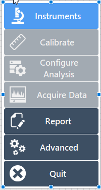

Not related to your code, but original question. Check out DMC
 => (It's Free)
You can get Radio buttons that look like this, and are resizable, it's a good target for a touch screen. I have added individual decals in the past to the buttons.
mcduff
 EDIT:
Here's a customized version of the control.
Message 5 of 31
