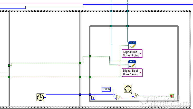

Ok, so I am working on trying to build a washer sorting machine for my engineering group project.
Firstly, the program was supposed to activate a solenoid to push the washers into a chute where they would cross over a photosensor.
Then, the machine is supposed to use a photosensor to determine if the washer has a hole in it or not. labview 1.PNG
The photosensor is suppoded to determine if there is a hole by telling the counter how many times the beam between the infrared LED light was broken. If it was broken twice, the washer is acceptable and will add one to the acceptable counter. If it was broken once, it is unacceptable because the washer has no hole in it and will add one to the rejected counter.
Then, it will need to turn a motor with a brush attached to it to push the washer into either an acceptable bin or a rejected bin based on the number of times the beam to the photosensor has been broken.
However, the machine is supposed to stop operation after there have been 25 acceptable washers which is why I wanted to be able to clear the clearable acceptable counter in order to allow the operations to be run again.
I'm sorry if this coding is painful to look at. I am very new to this and was placed in this position because apparently I was the most competent at using LabView.
As for this, labview failing.PNG,this was to let me know when the photosensor was reading so I could test my coding by running a washer over the hole the light shone through to the photosensor

Start to learn about state machines. They are a very good program structure for the kind of program you are trying to write.
They will also help you eliminate the sequence structures.

I want the values of the indicators to be able to be reset to zero, but then still be able to count after being reset.
I just tested it and most of the other coding works right now as the motor turns the the proper direction for rejected and acceptable washers, the solenoid works after I changed the time for the delay in between the true and false statement, and the photosensor accurately responds when the washer breaks the path of the light from the infrared LED.
I now know that it is a mess and that a state machine would work much better, but with this alrady working in the sequence that I want it to (as well as a rapidly approaching deadline), I just need something that will work for the time being and, aside from being unable to reset the "Holes" and "Acceptable (Clearable)" numeric displays while the program is running, this program seems to work.
I really appreciate all of the help on this. I don't want to sound ignorant or anything as I am very much a newbie on this and am probably way out of my league in much of this. Smiley Embarassed
Message 7 of 15
(6,143 Views)
Here's the problem you're running into:  You're using the flat sequence structure.  This has to start and then perform each frame in sequence.  It doesn't have a clean way to go back to another point and reset values while continuing the process.  You'll have to introduce variables into the equation (where we can already tell you don't know when to use these).  That makes things more muddy.
With the state machine (that wouldn't take a great deal of time to put together), you'd easily be able to move back to a reset state, then go back to what you were doing in the first place.
The reason people are questioning the constant being fed into the boolean is something you won't be able to answer.  There is NEVER a reasonable answer to the question you're being asked.  If you delete the local variable, you can wire directly into the indicator next to it.  As the indicator is sitting right next to the local variable and has nothing wired into it, it doesn't begin to make sense to create the variable here.  In most cases, you won't need to use variables in LabVIEW.
You bring up the deadline.  As crazy as it sounds, taking a quick crash course in LabVIEW often saves you more time troubleshooting and debugging than skipping the course and trying to see if you can figure out what's giving you a hard time.  In this case, there's lots of strange coding that is likely to give you a hard time (a 0 ms wait, excessive variables, etc).  If you REALLY only want something janky, you'll want to read whatever you're using as a reset in pretty much every frame to see if you need to reset the holes count.  That's the introduction of a large number of variables and is incredibly janky.  But, it's also the only way you're going to be able to update this mid-sequence.

Ok, is there any way that I can still have the hardware run in a specific sequence with the state machine? I had made many of the steps in the sequence as single labviews that would turn on and control the direction of a motor, would activate a solenoid, and would read a photosensor based on the instructions of my professors and I had thought that a sequence structure would be best for this, but I guess I thought wrong.Smiley Sad
Message 9 of 15
(6,084 Views)
Yes, the hardware/program/steps running in a certain order is the main benefit of a state machine and you should very rarely use a sequence srtucture. Here are online articles that will probably help you most at this point:
