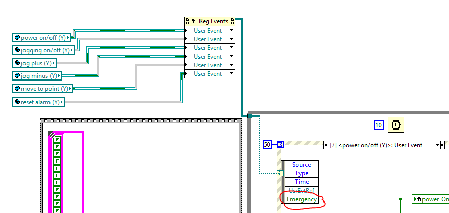

Just to illustrate:
I want this structure to be less cluttered, to work with clusters. Because there will be many user events in the final version. Also, why does it only say "user event" under the "Reg events" function and doesn't show my events by name?
Message 12 of 17
(1,804 Views)
Hi joptimus,
You can bundle the User Event Refnums into a cluster and pass this to your caller(s).
In the caller, select the required event.
To further clean things up, you could make a subvi out of the Create User Events (and bundle).
steve

Thanks. Can I have a cluster input for the "create user event" VI and use just one of those? I tried that and I cannot connect the resulting output to the "register user event(s)" function.
Message 14 of 17
(1,763 Views)
> Can I have a cluster input for the "create user event" VI [?]
Yes.
Did you give the cluster a label?
User Events can certainly be clusters (or arrays, or combos), but you should not combine User Events.
In this case, you would have one event (Registered in the Receiver) that has two functions.
How would the "Receiver" know which one you wanted to change?
steve
Founding (and only) member of AUITA - the Anti UI Thread Association.
Message 15 of 17
(1,741 Views)
Thanks, steve.
I have one final question please:
I now have moved the event creation into the calling VI. In the receiving/consumer VI, I'm reading the created and generated event into the register function and wire its output to my dynamic event registration:
The problem is, that in the event data node, I can only select those 4 items and not the value itself. I think this is a bug, because in another VI which built in the exact same way it works (although I'm not sure why it says "emergency", I never named any variable/function like that):
Message 16 of 17
(1,697 Views)
Do you ensure that the Globals are written to before they are read?
Dataflow must be incorporated that forces the definition of the Global to occur before you use it.
What is the default value of the Power on/off Global?
You might try running the program and then saving the Global (Right Click, "Make Current Value Default").
See if that fixes the "Emergency" label.
steve
