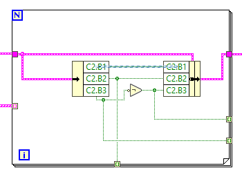

I am using this code as part of a plugin I'm writing, and I found an important bug that you may wish to correct.
The script works well when any cluster element has only a single unbranched wire attached. However, if you have a branched wire that terminates on a  tunnel, deleting the wire deletes those terminals, and they are not rewired by your script. Consider this diagram:
It's a trivial example, but common during development... I know I need those indexed boolean values, and I don't want those wires deleted.
You can fix this by replacing the Wire:Delete method with Wire:Disconnect Terminal. This preserves the wire and thus all its other terminals. If there are wire bits laying around afterward, there's a method to clean those up as well.

You should attach your VI script that shows what it is you are trying to do.
Why do you consider this a bug?  To me it sounds like you want the  Delete method wire to be different than what it is defined for.
My understanding is that a wire is everything that exists between its source and all its terminals.  Within that wire are joints that define where the individual segments meet or bend.
This is only a bug if the function only does something that the designer did not intend it to do.  It is not a bug if the user of the function thinks it should be doing something different than the designer intended.
Message 6 of 8
(5,086 Views)
Hi RavensFan, this is not about what I want to do, it is about the purported function of the quick-drop script that is the topic of this thread
From the original post:
"Very often I need to change order of cluster (un)bundle by name terminals, preserving wire connections."
I have described a case in which the plugin fails (aka a bug), because rather than disconnecting a wire (the method to use that fixes the bug), the script first deletes the wire, and thus does not preserve the wire connections.
Please review carefully.
