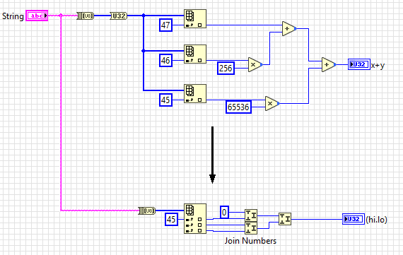

Hi saleh,
just a suggestion:
Message 7 of 10
(4,413 Views)
I would either clean up the string parsing or replace it (see image)
Randall Pursley
