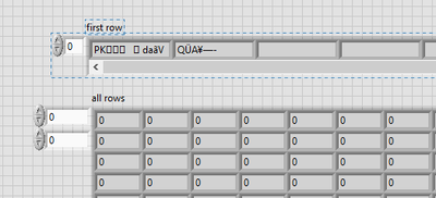

I've copied what you've suggested which successfully reports the file and folder names, however, when I run the VI the data doesn't match the original file. For all rows I get a matrix of zeros which doesnt match the dimensions of my data and the headings arent the same - see attached...
Any suggestions?

I managed to solve the previous issue using an alternative method of loading in the data as my data is .xlsx and not .csv
