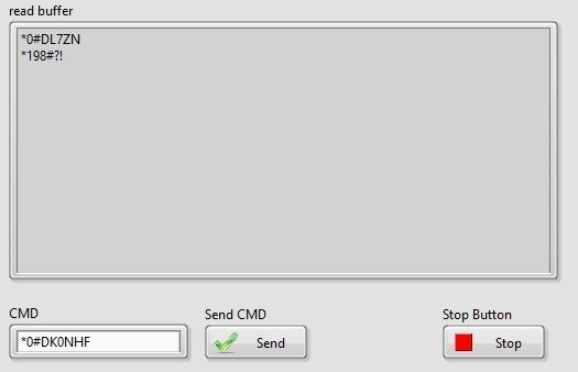

Reading garbage on serial port
Could someone please tell me why i get this garbage on serial port: *198#?!
I should get only the following as response: *0#DL7ZN
When i use RealTerm to communicate through serial port i get no garbage like *198#?!
Kind Regards,
serial.jpgBalázs

  1. One or more of your serial parameters is incorrect (bits, baud, parity, stop bit, flow control, etc)
  2. You are expecting ASCII data but are receiving binary data
  3. You are using "Bytes at Port" and that rarely works
I vote for #2 with a sprinkling of #3 for good measure.  😉
To the OP:
I believe that the second line is NOT garbage, but is, in fact, some additional information that is being sent.  I would make sure what you are SENDING is the same thing as you are sending "manually".
Did you check the programmer's guide to see if that is a valid response?

I also forgot, the data itself may need post processing. That is the device may be sending data in "Two's Complement" or some other form that is not "human readable" unless you decode it.

Instead of using RealTerm to communicate with your device, use MAX.  You can open a Test Panel for the VISA Port you are using, configure the Interface (so you know what settings you are using), and you can write to and read from the buffers, seeing just what comes back.  It seems curious to me that the picture you show seems to show a response to a Command sending back a two-line response, the second line of which is the "garbage" response in your Title -- was the first line meaningful?
Let us know what you learn using MAX.  Do you know how to avoid "Bytes at Port"?  [It depends on whether your device uses a Termination Character, typically <LF> = 0xA].
