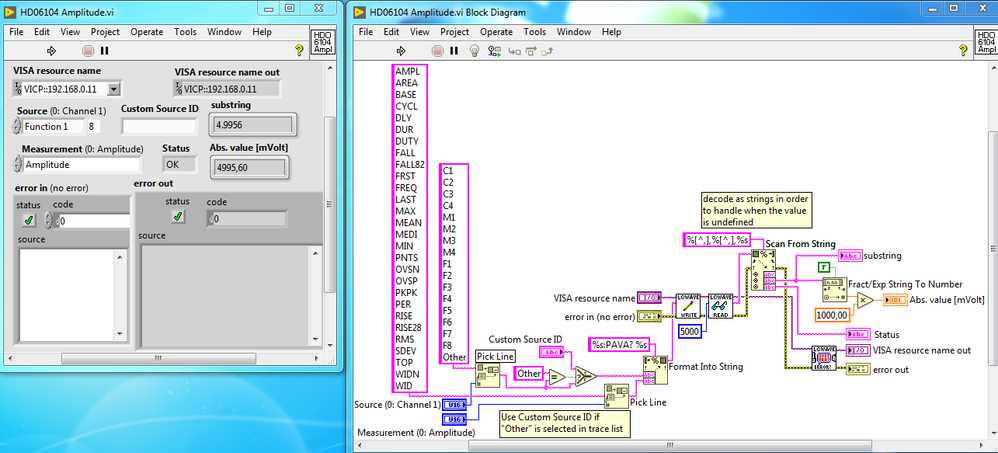

A square wave with amplitude 5V is an input signal to the Channel 2 of the oscilloscope Teledyne LeCroy HDO6104.
F1 is a Math function Absolute amplitude value of square wave in Channel 2 (C2), and
it has been adjusted manually to a value of 750mV.
When the VI is running the result shows only the peak to peak of the squaure wave as shown in the picture, not the value of the cursor that I wanted.
Anyone knows how to read this value 750mV by a VI.
Any hint/suggestion is greatfull.
Thanks in advance.

Did yo look at this code that was provided by Teledyne?

Thank you Tim very much for your reply.
I've downloaded and installed the program into my computer and take a look at it.
What I understood the purpose of this utility is to convert XMLDig files to ASCII-readable format,
and gives the user the ability to view and manipulate digital waveforms.
My task of this post is to create a VI that read the amplitude level which is adjusted manualy on the oscilloscope. I do not know what I can do more with this utility or I maybe note yet discover the benefit of it.
The utility has not thing to do with programming in labview.
