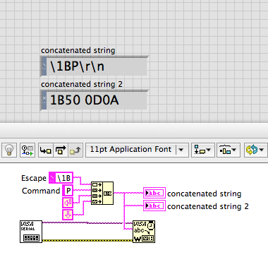

You have not mentioned which model of balance you have. One manual I checked has a very nice cable diagram and complete specifications on the RS-232 protocol. It uses somewhat unusual factory settings: Odd parity and hardware handshake.
It is quite easy to verify the string being sent. Just wire a string indicator to the write buffer input to the VISA Write. Set the display style to '\' Codes Display or Hex Display.

Thanks johnsold, I adapted my program as you suggested – but still no data.
