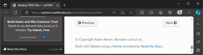

npTDMS has an option for reading raw data (scroll drown to the Scaled Data section)
I assume NI wrote the API for npTDMS, why don't we have this option in LabVIEW 😞

npTDMS is written by Adam Reeve.
https://tmesystems.net/

Maybe not NI; but I assume he is using a NI supplied DLL. He could have wrote everything from scratch which would be quite impressive. But anyway, we are a second class citizen with respect to TDMS. I would love to read raw data instead of scaled doubles like the OP asked. It seems possible.
