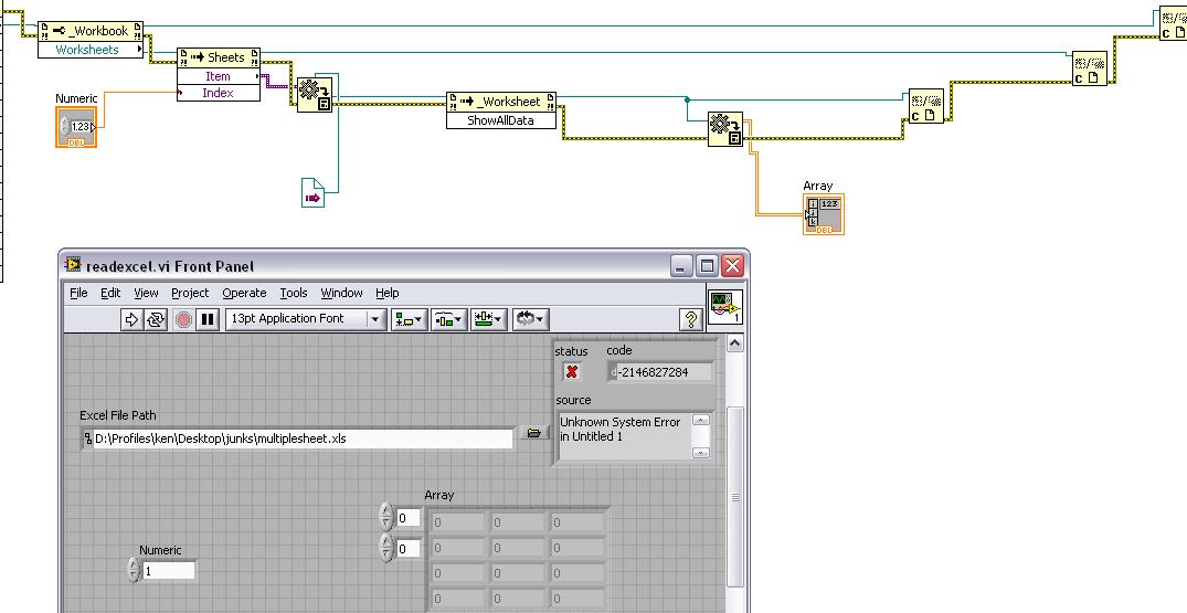

i got a small problem, from krsone examples, it is able to read from the range values indicated
but if i wan the read ALL the data, how am i gonna change it?
i've tried to remove the range and put ShowAllData, but it doesn't work
18329i4067C486BA059CCE
Message 7 of 15
(6,936 Views)
Why would you use the "Show All Data" invoke node.  The Show All Data method according to VB help "Makes all rows of the currently filtered list visible."
And why would you take a worksheet reference and try to convert it to a 2-D array?
Are you trying to capture all possible data on the worksheet (256 columns by 65536 rows)?  That is a lot of data and I doubt any real spreadsheet of yours will be that full.  If so, you can make your range A:IV and that will be all rows of all 256 columns of data.

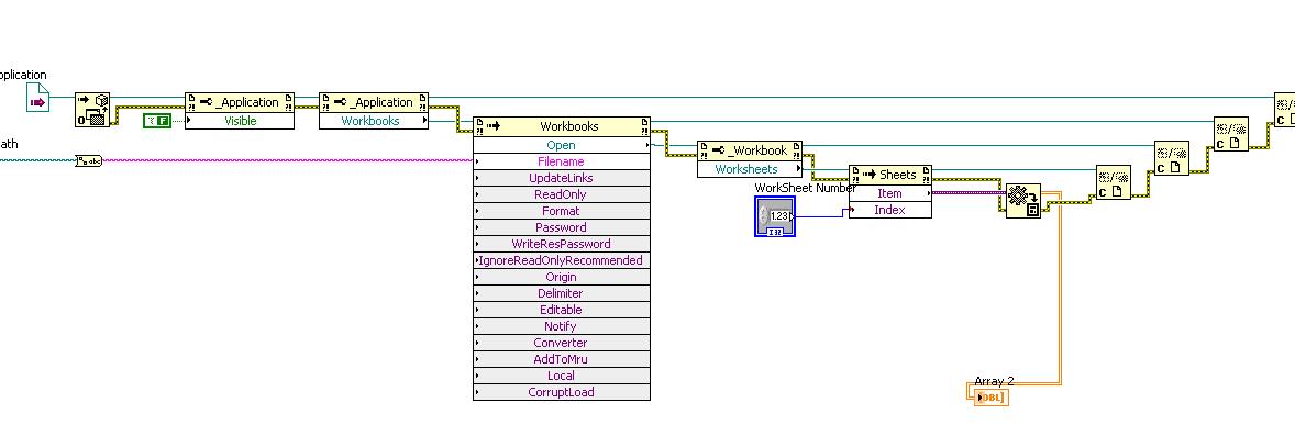

after much thinking and looking through, i edited some and now it seems that its not working
theres this error message "type mismatch" and i don't get it
all i want is to open the selected excel file and the selected worksheet and display all data.
