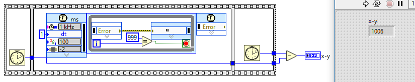

@MatiMarin wrote:
Yes, I tried to use RT functions, but as I developed the idea, I found comments about MS Windows not being able to work with those functions. I don't understand why, really.
In Windows environments, the OS is multithreaded and it decides when things run based on its internal best guess as to how to multitask.  So when a program tells Windows "sleep for X milliseconds", windows will sleep for at least X milliseconds, but it could be any amount more.
Here's a simple example:
My PC runs this anywhere from 1470 to 1520, when you'd expect to see 1000 or 1001 if everything was perfect.
If I switch to running a timed loop, it does much better because it has settings to dedicate to priority, processor, etc:
However, it's still not exactly 1000 or 1001 because it's Windows.  If it was run on a real-time system (which is what the timed loop structure is usually used on) then it would get it exactly (if there was nothing in the loop taking over 1 ms to run).
