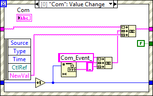

Tried to add a simple way to display "real time" serial data in a string indicator in a project, using a value signaling property and a event structure.
The event structure is to slow to execute/read the string text added by the Val(Sgnl) property(numbers of triggered events are correct).
Have i messed up somewhere or is this race condition expected(should i have used Queues instead)?

In your event loop you're just using the reference to the control to get the value.  Stop using that, and start using the "NewVal" terminal from the event (it's currently hidden, you need to expand your event variables or change one of the existing ones to it).
Because the lower loop runs at a higher speed than the upper event loop, the events are reading future data, effectively.  The "CtlRef" terminal there is not frozen in time, it updates with everything else.
I do agree with Altenbach that in this situation the event structure is being abused a bit here.  While events can sometimes be the best solution for data communication under certain specific circumstances (I'm thinking of a situation with multiple unknown parallel processes that need to receive lossless information sent to them, not exactly a common occurrence) , in this one it seems to be there just to avoid making a queue.

If you want the Com value that triggered the event, read the "new value" from the event data node. Using a reference to read the value will give you the current value of the control, not the value that triggered the current event. The lower loop spins so fast that the events get queued up in the event queue and then.
There is nothing wrong in the way it functions with a very short wait in the lower loop.
However, you need to re-think your architecture. It's backwards.

Some repeats here, but here are a list of things I found wrong:
1. No need to close an explicit reference to a front panel item.  It will be closed with the front panel.  Even when you try to close the control's reference, nothing will happen (it is literally a no-op).
2. Delete the Timeout event case.
3. Use User Events to send messages to your GUI loop.  This will decouple your UI from the process since you just need a reference to the event instead of the actual control/indicator.  Let the GUI loop decide what to do with the data.
4. No need for your sequence structures since data flow of the error cluster will force the sequence of functions.
5. You Done button really should be set to the Latch When Released mechanical action.  This can be done when you no longer need the reference.
Attached is a non-cleaned up version of your VI using User Events.

Just a few more comments:
  1. Wiring the FALSE to the event structure is irrelevant for execution order, because writing to the local variable is after the wire branch and thus still executes in parallel to the event loop. It does not matter here, but could give you race conditions elsewhere.
  2. None of your sequences are needed. If you want to delay the start of the lower loop, just wire the output of the wait function to the loop boundary. Don't use sequence structures to delineate code sections cosmetically.
  3. Closing a direct reference ("Com" after the upper loop) does nothing, so don't do that. (details)
In summary, use the event structure for user interactions and use e.g. queues to communicate data between code sections if needed.
