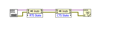

I want to test RTS/CTS operation between Labview and STM32 Board via UART?
(1,182 Views)
VISA lets you control the state of RTS and monitor the CTS signal through its properties:
If you were aware of this but don't feel this is what you need, you will have to explain in much more detail what it really is you try to do!
Rolf Kalbermatter  My Blog
(1,177 Views)
im reading data from stm32 board and if buffer gets filled it will write XOFF to stm32 board to stop transmission and if bufferis empty it will send xon to resume transmission , if something is wrong please help
(1,137 Views)
Take a look here:
(1,120 Views)
