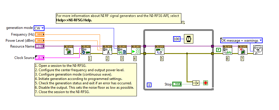

There is a RFSG example as follow:
For the frequency control, it cannot change the frequency continually when the code is running. I have tried to move the configure RF VI to the while loop, but still not work. Anyway to solve this problem?

The frequency control will only get read at regular intervals if it is inside the while loop.

Sorry I didn't get what you mean. Is there anyway to solve it?

To update the frequency during generation, you can either stop the generation to reconfigure the frequency then restart (see RFSG Frequency Sweep.vi shipping example), or set up a configuration list to step through a list of frequencies (see RFSG Configuration List shipping examples).
