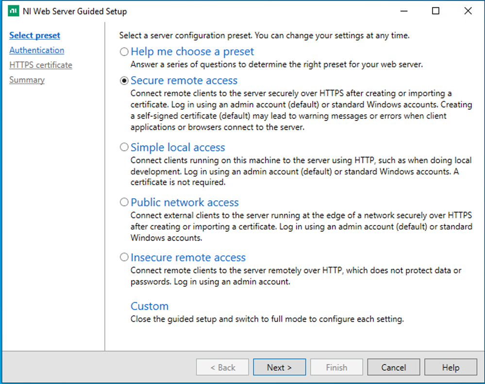

You may need to run the NI Web Server Configuration utility and configure the web server before the example will work.

I have it running (I also tried different configs). Each time I got the same error.
