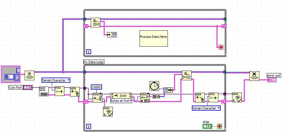

To open and close a visa session simply
a more elegant approach is to use two loops. one for receive then pass the data into a queue and process it in another loop

And what if I have multiple serial ports...I have the problem of one devices working on com 1 but not on any other port.
(3,300 Views)
there must be a visa close for each port
you could read all ports at the same time when data arives at any port
or you could just duplicate the previous example i posted for each port
Message Edited by James R on 04-03-2007 12:26 PM
- James
Using LV 2012 on Windows 7 64 bit
