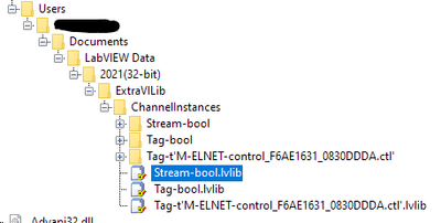

I don't really understand, what labview is doing. Why are those files in the users/documents folder, and not within the project folder? If someone else pulls this project from git, they are all missing?! Who told NI this is a good idea?
And why can't labview put all files into the llb and is instead creating more and more extern files and folders? (second picture)

Is the destination just on big llb with many streams in it? That will probably not work for channel-instances. I would report it to NI though because of course it should work and the application builder should take care of it, or give you an error during the build.
Try to at least separate so that you have one llb per "Channelnstances". Or if you need the source code preserved, just have it as a folder with preserved hierarchy.

the structure is not that complicated. We build specific test routines for every dut and export this as an llb. Each LLB contains a vi with a test software template, that will be called dynamically by our test interface (executable written in labview). Point is: the vis within llbs can be executed by the labview runtime without the need of having the full development on the test pc. So the llb is part of our "plugin" system. The structure has grown in one and half decade so please don't question it. I'd be the first to change it but that's "none of my business"...
however: I just found out vis are being placed in the <extralib> folder, that is per default in the userdata folder. I tried to move the code to the project but this just triggers labview to throw numerous file missing and reference fault exceptions eventually triggering the rebuild of the stream vis. Simply deleting the extralib content triggers it too, so yes, there is no need in caring about it.
So eventually there seems to be only one issue: duplicate file names in the auto generated extralib lvlibs (streams).
