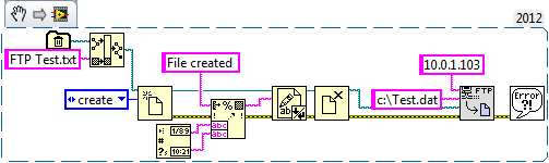

OK, power is back on.  My Remote device (a PXI controller) did not have a file, Test.dat, on its C: drive.  I ran the following piece of code, which creates a temporary file on my PC, writes "File created " and the date and time, saves the file, then FTPs it to my PXI, saving it as c:\Test.dat.  Here is the code:
Here's the directory of my Remote (the file times are off -- I got confused by EDT vs UTC).  Notice Test.dat at the end.
And if I double-click it, IE shows me its content:
As advertised.  I'm not sure why something similar doesn't work for you.
