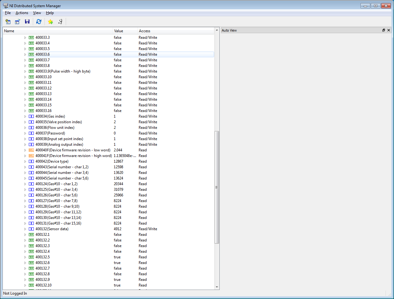

I am using the Distributed System Manager to communicate with my Sierra Instruments MFC. For the most part I am able to read in the values of its MODBUS registers. However there are some registers that the DSM doesn't appear to be able to read correctly.
In the 1st screenshot I show a working case.
Note the values shown for registers 400043 through 400045 are the decimal value of equivalent 16-bit ASCII encoded characters (as hex), and when combined give the serial number of the MFC. So in my current example:
400043 = 12598 == 0x3136 == "16"
400044 = 13620 == 0x3534 == "54"
400045 = 13624 == 0x3538 == "58"
Serial # = 165458

Hi JDragon,
What I've figured out is that there is a range of registers 40046 through 40123 (that are all16-bit ASCII encoded values) which for whatever reason are not being read in properly by the DMS (see image below). Below I just show that 40123 causing an error, but I've confirmed it starts at register 40046.
40046 carries the last 2 digits of the equipment serial number, which in this case are "null", since the serial number is only a 6 character value. Then the other ASCII encoded data which are not being read in are comprised of 8 registers each. Strange enough the very last string carried by registers 40124 to 40131 are read in OK. When the decimal values shown in these registers are converted to hex and then to ASCII it spells "Oxygen" as it should (Oxygen is the last gas ID in the list of gases).
What is also strange (to me at least) is that when the DSM tries to read from a problem register then all of the registers before the problem one are also not able to be read in properly even though they were read in just fine before (see image below).
