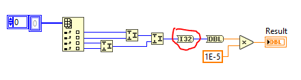

I am having trouble with seeing negative values (through a 1d array) on a I32 integer.
Here is the indicator:
Here is the VI logic for Pack Current:

You should convert your U32 to I32 before converting to double, otherwise it is interpreted as a positive number when converted to a double:

What you are doing also seems overly complicated and wrong. Multiplying an integer with 0.01 or 1e-5 probably deserves a DBL indicator because the result is unlikely to be quantized to integers.
Here's what I would probably do instead (much easier to debug and much less likely to make mistakes!)  🙂
