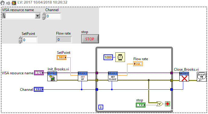

I'd like to control my Brooks MFCs from LabView. To do that I have downloaded the subroutine Brooks Labview DLL available here https://www.brooksinstrument.com/en/products/accessories-software/product-software/brooks-labview-dl....
Using their example I am able to communicate with the MFC, I can write a SP and the gas flows. Unfortunately I am not able to read back the flow value. The answer is always 0. It is strange because if I write a value higher then 100%, in the reading part it says the value is out of range. So basically I have a communication, I can write but I cannot read. As second check I have used the Brooks Smart DDE software which, communicating with Excel, can well read the value, so it is really a problem of LabView. Can someone help me? Thanks

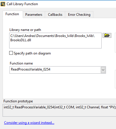

  1. Did you add the lvlib to your project?
  2. Did you check that the DLL file path is correct in all the subVI Call Library Nodes?
edit: when you see a broken arrow, you can go to the function by clicking on the error description, and fix the path for the DLL (or just use the DLL name, LV should be able to find it). I guess your problem is that I set (bad habit) an absolute path for the DLL calls:
(and you do not have the DLL behind the same path):
