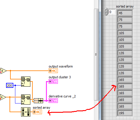

please show also the "raw" data before plotting them in the graph!
I get this when running my version of your VI:

Hi max,
easy solution: when you don't want to have horizontal lines in your XY graph you should not use the same X value more than once in your data!
Prove: sort the X array and display it in an indicator. You will notice, that several X values occur more than once in your X data!
See this:
Message 14 of 17
(2,342 Views)
Oh ..double x values.. 😞 ??
Thank you so much for your help! I will have to look for the reason for these double values..
