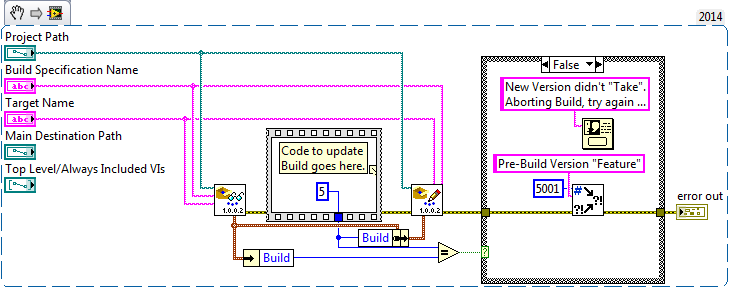

Very clever!  I didn't think of deliberately aborting the Build if it didn't "take".  I took your idea and "simplified" it a little, as follows:BS PreBuild Action.png
Some may want the simplified version I understand.  But for me I wanted a more robust VI, one that would work if a project had multiple build specifications of applications, or multiple installers.  Some developers may have two applications one that is normal, and another with debugging turned on and I wanted the versioning to work consistently there by grabbing the newest version and using it.  And in all my cases, if there is an installer it should be the same version as the EXE.
