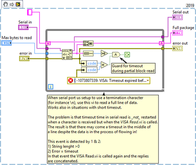

I came to this old posting when having problems with timeout in VISA Read.vi when configured to use a termination character with the intention to always read full lines.
Issue is:
When VISA serial port is setup to use a termination character (for instance \n) you would expect that you always get a full line (/package) of data or a timeout. This is not the case however. The problem is that  timeout timer in VISA read.vi is not restarted when a character is received, but when the VISA Read.vi is called.
The result is that there may come a timeout somewhere in the middle of a line (package) despite the data is in the process of flowing in!
Slow baud rates and short timeout aggravates this problem.
Of course you will know that the line is incomplete due to the timeout. The next message is likely to pass with proper termination, but the content will be missing the previous part which gave timeout - so, you will accept an illegal line if assuming that no timeout means a full line was received. Most of the time this will pass ok - but not guaranteed.
Below snippet of code deals with this.
The offending event (timeout in the middle of a line) is detected by::
1) String length >0
2) Error == VISA Timeout
In the event of 1) & 2) the VISA Read.vi is called again and the replies are concatenated.
To test it: Set the timeout shorter than the line length and it will still work reliably.
As is customary, set Max bytes to read larger than the longest line.
None of the replies here seamed to solve this problem so I decided to post my solution in the hope it is useful for other having similar issues.
