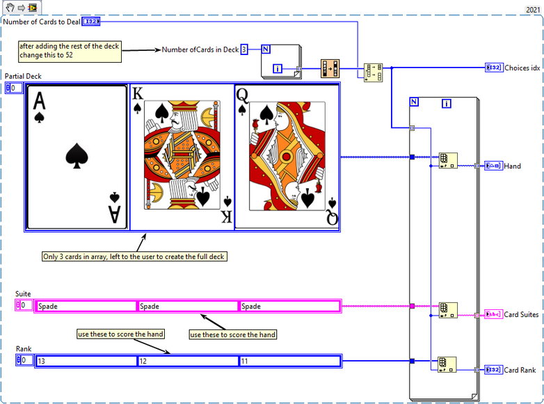

my program will deal 5 random cards from a deck of 52 cards and display them on the interface(each card includes information about its suit and numbers,and no card can be repeated)
sufferring issue in I use HEX so card number is 1-9,A,B,C,D
how to transform card numbers to A,2,3,4,5,6,7,8,9,10,J,Q,K

You can "transform" by using a lookup table...
Why do you use "HEX" instead of ordinary integer datatype? (Posting from mobile, so no access to your VI.)

Use LUTs (LookUp Tables)!

You can make it more fun by adding some images. Generating the hand is the easy part, scoring multiple hands is a more fun code challenge : )

I would cache the LUT once at the start of the program. This will be so fast that measure timing is pointless.
  • You can replace the format with a bundle if you wan the old cluster output.
  • As has been mentioned, cards are not hexadecimals, because a 10 would turn into a A, to be confused with an Ace.
  • Often suits are ordered with the Ace last (see e.g. the first picture here), simplifying the code.
  • Cards are integers and there should be very little orange anywhere (except for the dice if you need it)
  • There is no need to maximize the diagram to the screen.
  • Of course this code is incomplete. You might want to shuffle the deck once, then keep drawing cards as needed, simulating a real game.
  • This is more like a programming skill exercise. It might be much nicer (and simpler!) to use a picture ring with 52 card images. I have seen them, so search the web. (EDIT: Jay just posted an example while I was writing, so see post above!)

Partial deck how to create image, need to use picture ring vi.?(unfortune don't has this vi)
Index array how to connect none double data in n-dimension array

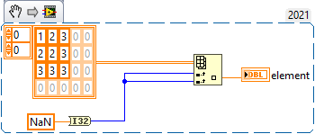

tks your reply
1) This is a way to load a png file to a LabVIEW picture object. There are many ways to programmatically modify the image once it is loaded. Once you load a picture you can make it constant and save it with the VI.
2) Not sure what you are asking, maybe this helps?
