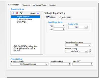

I'm a pretty new user (first day with labview and this new data logging equipment).
I have data coming in the form of voltage for several sensors, as well as data coming in the form of thermocouple readings.
I won't talk about temperatures as no conversion is needed since the DAQ assistant outputs temperatures directly.
However, out of the voltage input device, I am reading 3 inputs:
for now, I am running everything nice and slow.
I am trying to do relatively basic conversion for the pressure transducers, probably overkill I am using a formula node. I was doing it with operators directly on the signal when I first had one test signal. However, now that I have 3 signals, I am using the index array with 0, 1 and 2 for the 3 channels to get the voltage and convert it.
Note that for the third signals (encoder with voltage output) the conversion is pretty significant as I converting this directly into a calculated volume. Anyway that part is correct as the numerical output checks out.
The issue I am facing is getting this converted data back into a form that the waveform will digest. I don't really care for plotting the volume data but ideally I would want to get both pressure plots on the same wareform. All my attempts at merging the data put them in the same "column" instead of 2 separate columns.

You should definitely not use formula nodes.  If you've done your DAQmx correctly, you'll get out a 2D array of Dbls, 1000 rows of 3 columns (assuming 1000 samples and 3 channels of A/D) that you need to change to "real-world values".  You know (I hope) how For Loops work with Arrays -- when you put a 2D Array into a For Loop, by default, the For Loop puts an Indexing Tunnel (one with a pair of square brackets, [], suggesting an Array) in place of the solid square Tunnel, indexing through the first Index (i.e. processing a Row at a time).  OK, you've got a Row inside the For Loop, now you want to do a different computation for each of the columns.  How do you get each of the (3) columns?  Use another ________ (fill in the blank), which will give you each of the three columns.  But you want to do different things for each column.  What lets you choose among alternatives?  In "case" you haven't learned about the Case structure ...  What do you wire to the Case "selector" (the "?" terminal)?  The Index (i), which for three columns, will be 0, 1, and 2.  Inside each Case, you put the code (not a formula, program the arithmetic!) to change the A/D value into Pressure or Angle.  But what's with that Broken Arrow?  If you have a Case Statement, you must tell it what to do with every argument it can see.  Here, it is any I32 value (that's a lot of number!), so you want to handle "all the rest", which is where "Default" (spelled with the quotation marks) comes in.  Simply add a "Default" case (or combine "Default" with one of the other cases, such as making the first case read 0, "Default").  Presto, done-O.

you cannot inline a sub.vi containing a formula node, therefore you are meant to avoid formula nodes
also, formula nodes turn out to be significantly slower in comparison to LabViews operators.
in terms of math formulas, formula nodes are often easier to read, therefore formula nodes are good for prototyping.
does it work before conversion? if yes, then you need the opposite of "index array" which is "build array"
