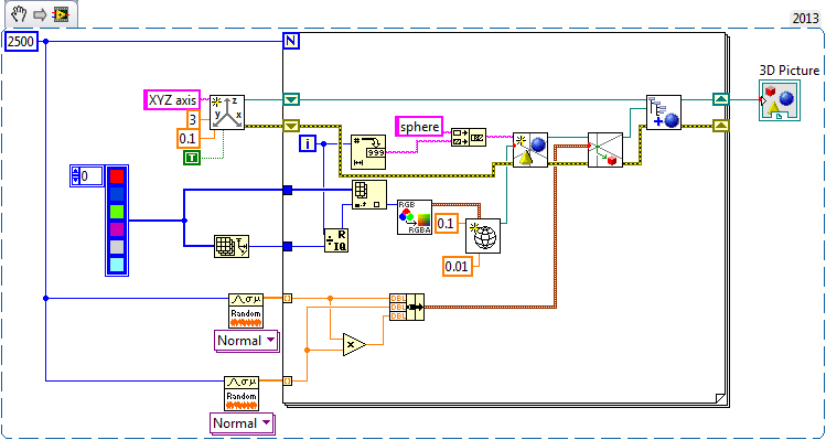

Hi All,
Let me explain my problem with an example. Suppose I have a data set as follows.
X-Axis              Y-Axis                   Z-Axis                   Color_Code
0                           0                            0                                  0
5                           5                             5                                 2
10                         5                            2                                 0
15                        9                            12                                 1
2                           14                          7                                  2
So each point is defined by its X,Y and Z axis values and an associated color_code.
lets assume that color_code=0 means red color
                              color_code=1 means blue color
                              color_code=2 means green color. I have only three color_code for now.
Each point should be plotted according to its color code.
How do I control the color parameter of the plot for each point?
I was looking for an answer in the forum and came across this solution by DavidJCrawford. However it takes way too much time to plot my 2500+ data samples. Is there any other way to do it?

What is the time you are looking for? I used the 3D Picture control with colored sphered to create a graph and I was able to get less then 1 s.

Hi Barp,
Thank you for replying with a solution. It takes very less time to plot the 2500+ points.Smiley Happy
I made a few changes to your program to suit my requirements and came across a few problems.
Problem 1: When i fix the Length parameter of Create 3D Axis.vi to 3, I am unable to plot a point whose axes values is greater than 3. This has been replicated in the attached vi.
Problem 2: I tried increasing the Length to 7(Can you please change it manually in the program to replicate it). Now the axes length increases but I am still unable to view the point(6,6,6).
Problem 3: I am not able to rotate/tilt the plot the way its possible when using 3D graphs.
Hoping to solve the issues.
Regards
Aveo
Message 3 of 11
(7,232 Views)

@aveo wrote:
Hi Barp,
Regards
Aveo
first, right click the 3d plot and set the camera-control to "oriented":
then try to zoom out by pressing shift + drag the mouse during left-clicking
Message 9 of 11

Hi @alexderjuengere,
Thanks a mighty ton for showing me the details of it.
And thanks to @Barp for finding the awesome solution. It works wonders with medium size datasets in terms of execution time. I was trying to plot the 4D graph using another method suggested by @thoult
@thoult wrote:
My apologies - I forgot to mention that you should use the 3D Scatter Plot on the same palette and access the colour ramp settings via properties in the same way.
Your initial post, example data and subsequent post were unclear as to needing multiple colour values per Z. You should be able to achieve this with multiple plots in a 3D scatter plot and separate colour scales for both
I tried to plot the dataset as mentioned by thoult(it is being used by others also as seen here by @DavidJCrawford). However it was taking ages to execute- a dataset of 1000 points was taking around 30 minutes to get plotted on my 2 Ghz Core2duo PC(Sorry for the poor config) Smiley Sad
However the method by @Barp takes just a couple of seconds- Thumbs up! Smiley Happy
However I could not tilt/rotate the plot. Thanks to @alexderjuengere for providing the solution for that.
I just want to add a few more snapshots to clear the procedure even more.
