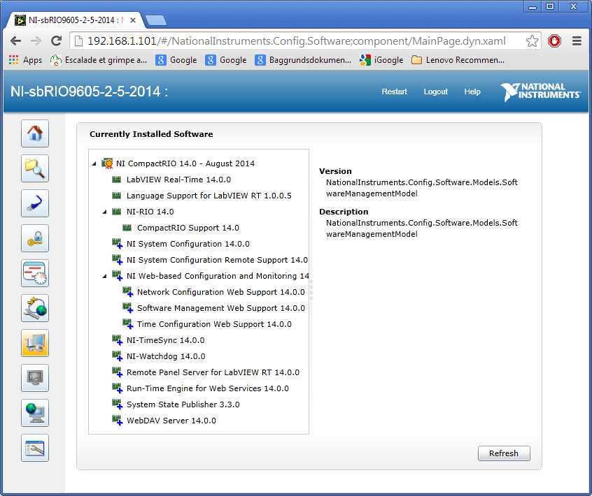

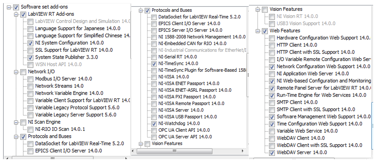

Hi!
With some more ideas from NI support, I have come to that it is a software component missing at the sbRIO. It is working if I from MAX install all components, but in production I don't want to have installed not used features.
Below is the features I have installed, any ideas to what I am missing?
In general I would like an overview over which components that are required for which features.
Regards Anders

SSL Support for LabVIEW RT - I'm not sure but the password might be encrypted using SSL so LabVIEW RT running on the sbRIO would need to have support for it. Definitely worth a try. Unfortunately it isn't always that obvious what you need installed on the target for things to work.
(blog)

Hi!
No, that did not work...Smiley Sad
Better ideas?
It seems as I must try more...
BR Anders
Message 8 of 9
(6,147 Views)
I went the long way with try and failure... so the answer is:
HTTP client with SSL support
