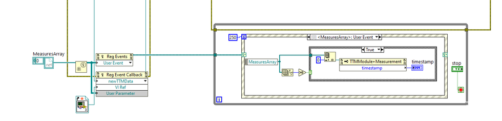

My library in C++/CLR (.NET) generates an event that returns a System::Array of a struct (so, an array of .NET objects).
In Labview, i'm trying to attach a callback VI and then pass the array of structs back to the main VI using events:
The problem is that when I access the fields of the structs passed back into the main VI, i get strange and different errors, for example:
However, if inside the callback VI I loop over the array and then copy all the structs to an array of native Labview objects and then pass back the native array to the main VI, everything works good.
This make me think that the problem is that when I pass the array of NET structs back to the main VI, for some reason the structs got garbage collected and I try to access a deleted struct.

Can you post the code of the event structure where the user event data comes back in and gets processed?
Error 1 often means a reference is the default/null value, and in LabVIEW it's possible that you may have done something with the code that reverted your array to contain default values instead.   Someone new with LabVIEW might not notice this happening... one very common thing to happen is that the default output from an event structure is set to "Use default if unwired", so if your event return data passes through one of those it can null the references.

LabVIEW requests the CLR to pin all .NET object references that your block diagram exposes - either by requesting the creation of a new object (constructor) or an object that is returned from a method or property. This is specifically to prevent the situation you are describing, as well as prevent the GC from moving those objects when defragmenting.
The consequence though is that, once you are done, you should use the Close Reference node on those .NET references - this lets the CLR know to un-pin them allowing the GC to do it's work. LabVIEW will also do this for you automatically when the top-level VI (your entry point) finishes.
As has been said, the problem is likely elsewhere, possibly in the setup of your event structure. Posting your code will help.

I'll try them. In the meanwhile, this is my event handle loop:
Th event handle loop just checks if the returned array has at least one element and then gets an uint64_t property and prints it on the panel.
