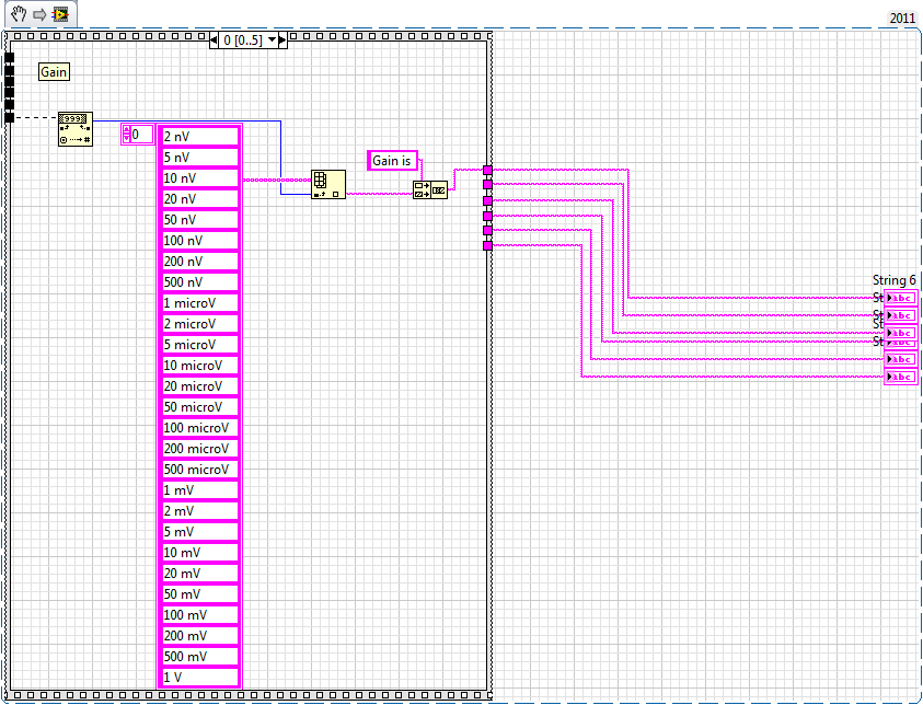

First off:
Replace those arrays of strings with Type def'ed enumerated controls!!!! See attached Reserve State.ctl
Always use unbundle by name- really a lot cleaner and self documenting.
As for getting the data from the producer loop (where the read is) to the Consumer (supposedly the write file routine) look into the Template for Producer/Consumer Design pattern (data) to see how Queues workUntitled.png

Jeff, am I looking at the same code as you? I don't see what strings to replace with typedefs, and I don't see where the producer consumer architecture would come into play here. Or even queues, for that matter.

You need to create a cluster constant of the type of cluster to bundle and wire it to the bundle type input.  then you'll be golden.  without the "prototype" of the cluster LabVIEW does not have enogh information to creat the FP objects (Control or indicator)
These arrays
