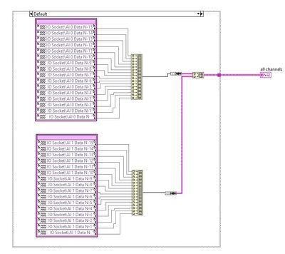

Trying to formulate again and explain better my problem.
I've set the interleaving factor from 1 to 2 and passed it to the ADC but I'm not receiving half of the samples (ofc, the FPGA design shall be updated to suport it).
Here is the acquisition chain:
Acquisition chainAcquisition chain
I have circled the channel data generation on the left and underlined the DSP processing chain on the right.
Here is the channel data generation VI:
TLDR; The problem is: if I interleave the channels data, my array fixed size grows from 16 to 32 and the following DPS chain only supports 16 sample per cycle (16 SPC)
