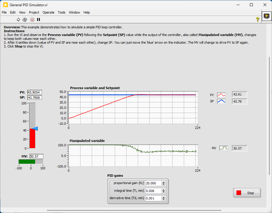

I would start with creating a real toplevel loop with defined timing.
Currently you seem to be running it in "continuous run" mode (a mode that should be called "restart from scratch when done" instead!). If you look inside the code of the PID subVI, there is a "first call?" that initializes the internal code when called for the first time. If you use "continuous run", this is always true.
LabVIEW ships with a nice example, so study that first. Open the example finder and look for "General PID simulator".

Hi Emma,
@plssendhelp1506 wrote:
Hi everyone, just wondering am i doing something wrong here ?
It seems you don't understand how a PID controller actually works…
current supposed to affect the temperature but it doesn't implies that temperature and current needs to be added up so that total will be 200......
Christian already gave advice, but I would like to add:
You set an output range of ±200 and the pv is (much) smaller than the sp so the PID controller will output a value to minimize the error, depending on your PID gains. This is expected operation of the PID!
Btw.:
  • To understand PID function it would help to use the default control/indicator labels (setpoint, current value, output value)!
  • Why do you expect a "temperature" output value from PID?
  • What is your intention about using (default?) PID gains?

Hi Emma,
after looking into the example, am i right to say that SP is the value that we set while PV will increase itself to sort of match the value in SP? If I were to change the SP indicator from 0-100 to 0-4 does that mean I also have to change the value for MV?
You know how a PID control actually works?
  • SP: setpoint defines the required state of your system (aka plant in the example VI)
  • PV: measurement value describing the current state of the system
  • MV: PID output to drive/influence the system by changing an actuator
You "don't have to change MV", the PID will calculate the MV value…
