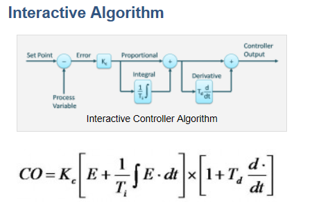

Thank you for your timely help. But, (maybe I misunderstand your mean), setting Kp = 0 and Ti = non-zero value may only exclude parallel algorithm, still the interactive and noninteractive ones behave the same. Can you please clarify a little further to me?
The following pictures are grasped fromhttp://blog.opticontrols.com/archives/124. .

It is rare to see that structure you have labelled the "Interactive Algorithm" used in practice - so normally you are just trying to distinguish between ideal/parallel. Different people/companies use different names for the structures, so I always to use the block diagram or equation to distinguish.

Just to clarify the terms used for each structure:
  • what I call the "Ideal" (and is shown above labelled as "Non-interactive"), NI refer to as the "Academic" structure. I do find this naming a bit strange, as this is certainly the one which is more widespread in applied control - as it is simpler to tune by manual tweaking. And when I got taught about PID it was the parallel form. Oh well.
  • what I and NI call "Series", is shown above labelled as "Interactive"
  • we all call the parallel one, "Parallel"
If you work with industrial controllers, using their pre-built PID blocks, you will find different manufacturers call their PID structures different names, so I always check the equations or block diagrams to distinguish.

AndyCleg,
Maybe the term "interactive" and "noninteractive" come from the coupling between the I and D action?
You are quite right to check the equations or block diagrams in order to distinguish:)
