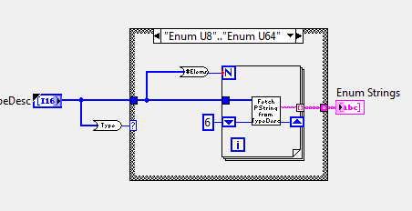

Any chance of a hint as to how you do this? Although the Get Type Information seems an obvious choice, I don't see how to get the output without a Variant To Data, and a case structure for every type in the enum, with constants for each type manually added. Is this what you've done?
There is an OPEN-G package for dealing with variants, which illuminated things for me.
The TYPE DESCRIPTOR for a variant includes a basic type code.  This is a byte which declares the variant to be a U8,U16,U32,U64,I8,I16.... etc.  There are four values that are special: Enum8, Enum16, Enum32, Enum64. They're all the same except for the size of the DATA STRING attached.
Remember that the strings of an ENUM are PART OF THE DATA TYPE.  Unlike a menu ring or something, the enum will not coerce if the strings do not match.  They are CARRIED AROUND with the enum value.
The TYPE DESCRIPTOR also includes a field called # ELEMENTS.  In a lot of cases, this isn't used, but for the ENUM types, it indicates how many strings there are in the enum type.
So, in the TYPEDESC, extract the #Elements field and use it to extract the enum strings.
The strings are stored as Pascal strings, meaning a one-byte count and then N bytes of ASCII.
So, now you have an array of strings that are the possible values in the ENUM.
The DATA STRING then represents a U8,U16,U32, or U64 integer, which is the index into that array.   When reading, that U8 or whatever wires directly to an enum indicator.
When WRITING, my situation comes from a string.  I match the string to one of the enum strings and use the resulting index as a U8,U16... value to flatten into the DATA string.
