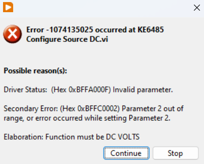

I am trying to operate a Keithley 6487 picoammeter from LabView 2022Q3.  I have managed to get the machine to communicate with the LabView code by installing the Keithley I/O Layer https://www.tek.com/en/support/software/application/850c10 and the appropriate driver https://www.tek.com/en/support/software/driver/models-6485-6487-and-6514-ivi-visa-based-driver-visua... . I am using an RS-232 to USB connection. However when I try a simple program to set the voltage source to a DC voltage, my program returns an error as seen in the attachments while configuring the voltage source.  I have checked the driver documentation but I cannot understand the required inputs.
Does anyone know what I am missing?
Thank you in advance!

It appears that any attachments you made did not work...
It would be best if you posted a screenshot of the error in-line with your post instead of making the error message an attachment.
It would be even better if you could post the VI you made.  If you do a "Save for previous version" back to 2019 first that would be better.

Yes, apologies, I'm attaching the VI and error message again.
