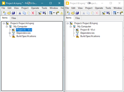

I have found a solution to the problem of sometimes missing projects when multiple project files are open simultaneously and a solution to the problem.
Problem
  • Open two Projects as shown in this screenshot.
  • Open ProjectA-VI.vi in Project A.
  • Activate the Project Explorer Window of Project B
  • Return to the Project A - VI.vi window and execute Locate in Project from the File menu
     "This VI was not found in the project " error occurs.
Use "Application.Project.Owning Project" instead of "Application.Project.ActiveProject" to get a reference to Project.
