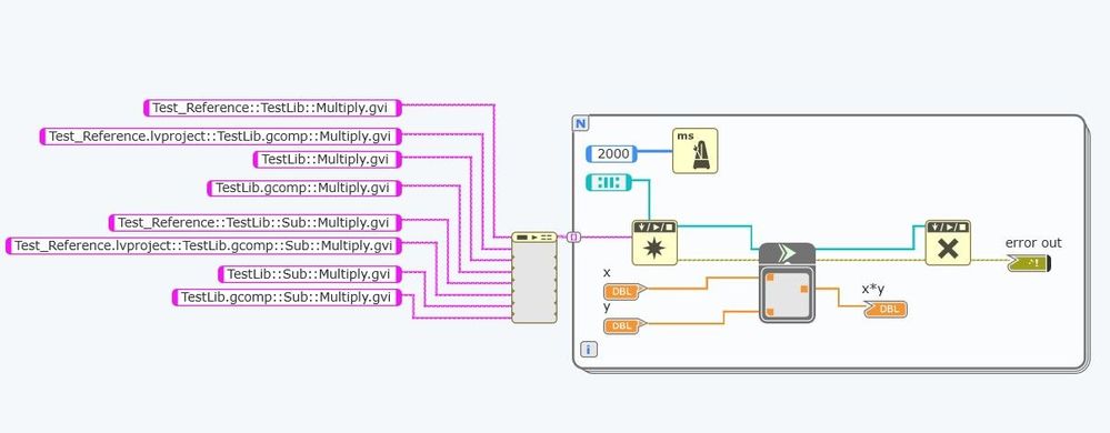

I always get an error when I call a VI (*.gvi) via "open VI Reference".
Is that posible in LabVIEW NXG?

Look at the pictures, please.

Hi Muaadh7, VI name "Multiply.gvi" is not enough. You must add a library name.
In this case, try "TestLib::Multiply.gvi".
If the VI is in Sub namespace, you can access the VI by "TestLib::Sub::Multiply.gvi".

I tryed all options butt it dose'nt work.

In ordinary LV you can place a VI reference constant and drag a VI into it, there's no similar possibility in NXG?
/Y

Thank you Yamaeda.
I dragged the VI in a constant reference.
And I realized. He has a different name than is displayed in the library (TestLib) ...(I have no idea why)..See picture.
It works now. 🙂
