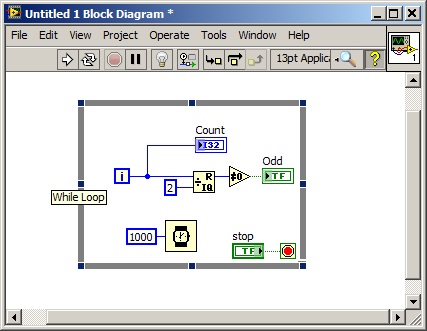

For example, I have these numbers from 0 to 112233. It will start counting from 0 and shown it on an output indicator. When it is even number (0,2 or 4,...) the Boolean indicator will become false, but when it is odd number (1,3 or,...) the Boolean indicator will become true.
I'd like to ask if it is possible to detect the values changing in output indicator when it start counting numbers from 0, and then the Boolean indicator will become false or true depending on even or odd number shown on an output indicator? How can I do that?

Tip: Use "modulo" (called Quotient and reminder in LV) by 2 and compare to 0 or 1 (regarding even or odd).

Most logic primitives will work with integers. AND with 1 then compare with zero.
Lynn

A bit like this Smiley Wink
Message 4 of 17
(11,714 Views)
AND with 1 is way more effecient than the Quotient & Remainder to divide by 2.  I recommend following Lynn's example.

It may not be that much faster. In the little test VI Q&R takes 581 ms for 10^8 iterations while AND takes 503 ms. That is 78 ps difference. Hardly enough time for a coffee break. Unless you drink really fast.
Yes, both are "fast enough" for all practical purpose. Even thought they are nealy identical in speed, the Q&R shows more variability in execution time (10% variability), while the AND is singificantly more stable (>1% variability).
(Make sure you disable debugging for a 10x speedup overall)
It also seems that the AND code folds better. If we change the control to a diagram constant, the AND version speeds up by a factor of two, even though no folding is shown anywhere inside the sequence structure. I have no idea what that means. 😄

I also tried Rotate with Carry. The Carry output gives Odd directly. Its speed is almost identical to Q&R.
