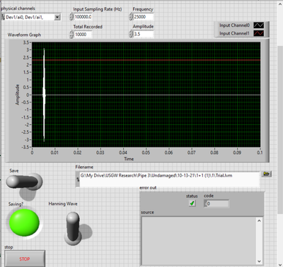

I'm working on a research project with LabVIEW 2018, an NI USB-4431, and some transducers. The idea is that an actuating pulse excitation is converted to a mechanical wave at one transducer. This wave will attenuate through a solid medium and be sensed at another transducer some time later. There, the wave gets converted back to an electric signal and picked up by the DAQ. So naturally, there will be a time delay between the generated signal at the actuator and the response signal at the sensor, albeit a small one. However, my results usually show both the actuated and sensed signals recorded by the DAQ at the exact same time:
It may be difficult to see the sensed signal (green), but if you squint you will notice it peaks at the same time the actuating signal (white) does. Here it is again but zoomed in:
I checked the sample indices to verify. So I believe the problem to be misalignment of analog input and output clocks.

Are you suggesting that I select multiple input channels in the front panel when I use the drop-down? Because that's what I have been doing; sorry I probably should've attached a screenshot of my front panel. Here it is:
Or are you suggesting that I wire two separate AI blocks in the block diagram to the same graph output rather than one AI block and one AO block?
(1,506 Views)
So is your plot on the screen (the green and white) two input signals? If so, then they're already sharing a clock, and it's probably electrical noise or something in your system. If you're plotting the AO signal with the AI signal, then clock shift could be an issue.
Kevin's thought was to just use pure AI instead of using any AO to do your timing. If you jump a wire from your output to another AI then you can sample both of them and not have to worry about any clock sharing. Plus you could then use any other signal generator without modifying your program.
But to answer your question- right click the Timing source dropdown, select "IO Name Filtering", then check the box for "Include Advanced Terminals". SampleClock should then show up in the list.

Depending on your signal conditioning ... are you shure that the grenn signal is comming from your sensor?  How does it look like, if you don't mount the sensor?
I just asked myself if that green signal is crosstalk?
and the green signal arives prior than the exitation signal ...  filter artifacts?
